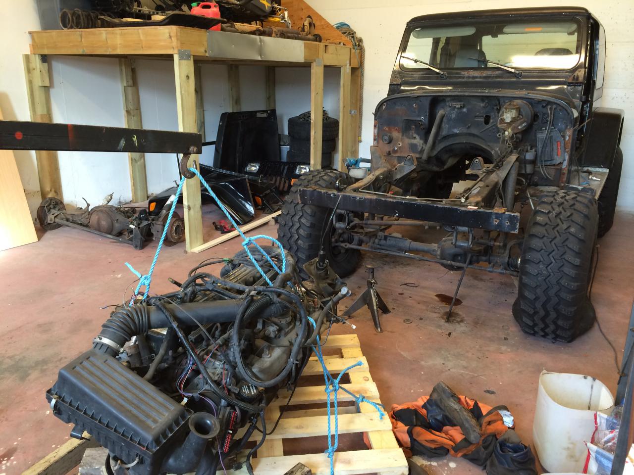

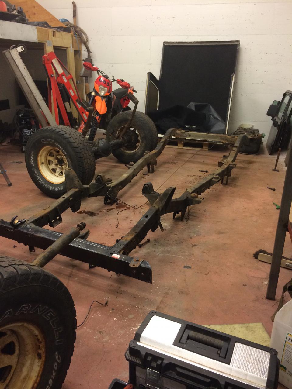

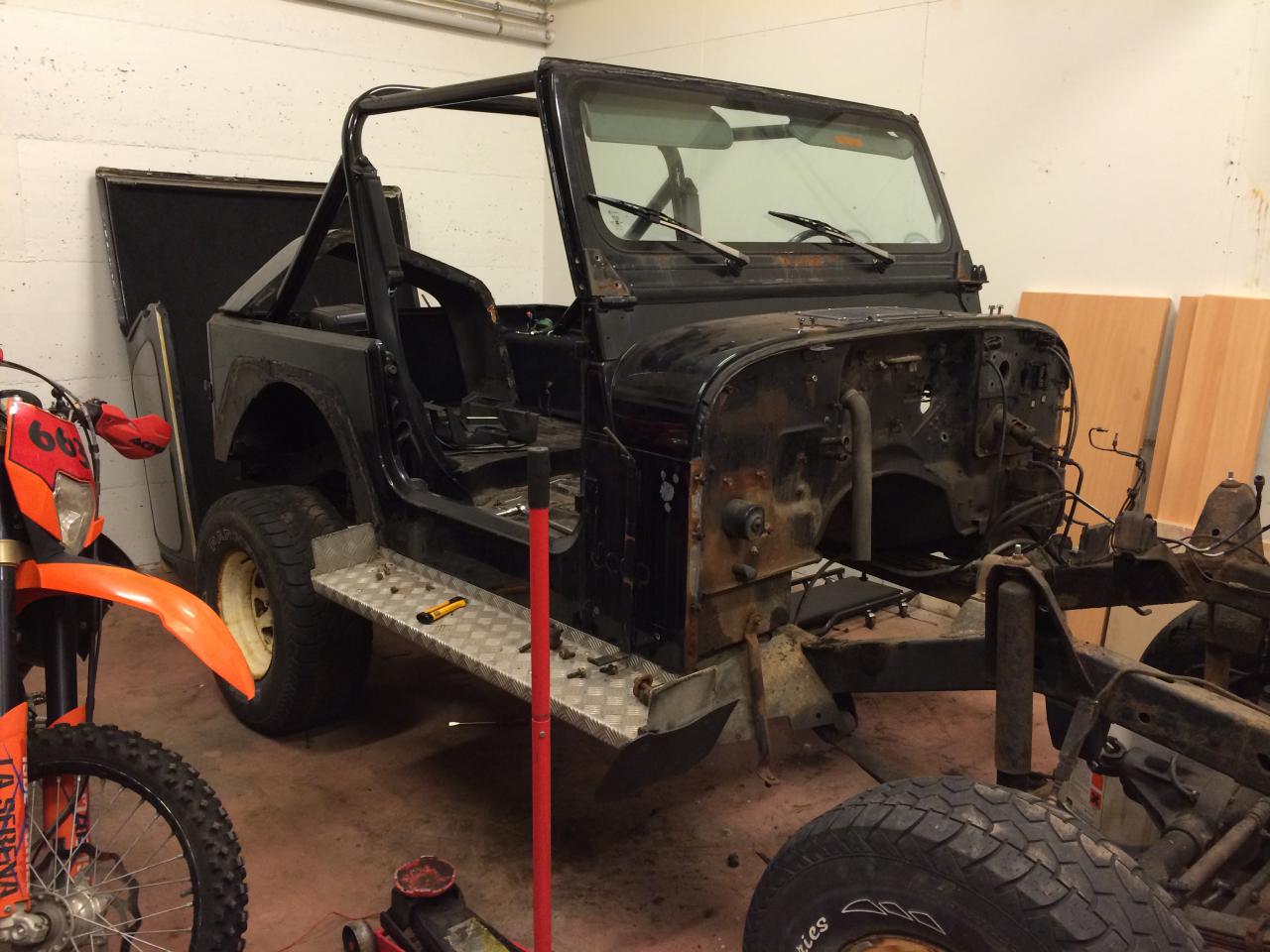

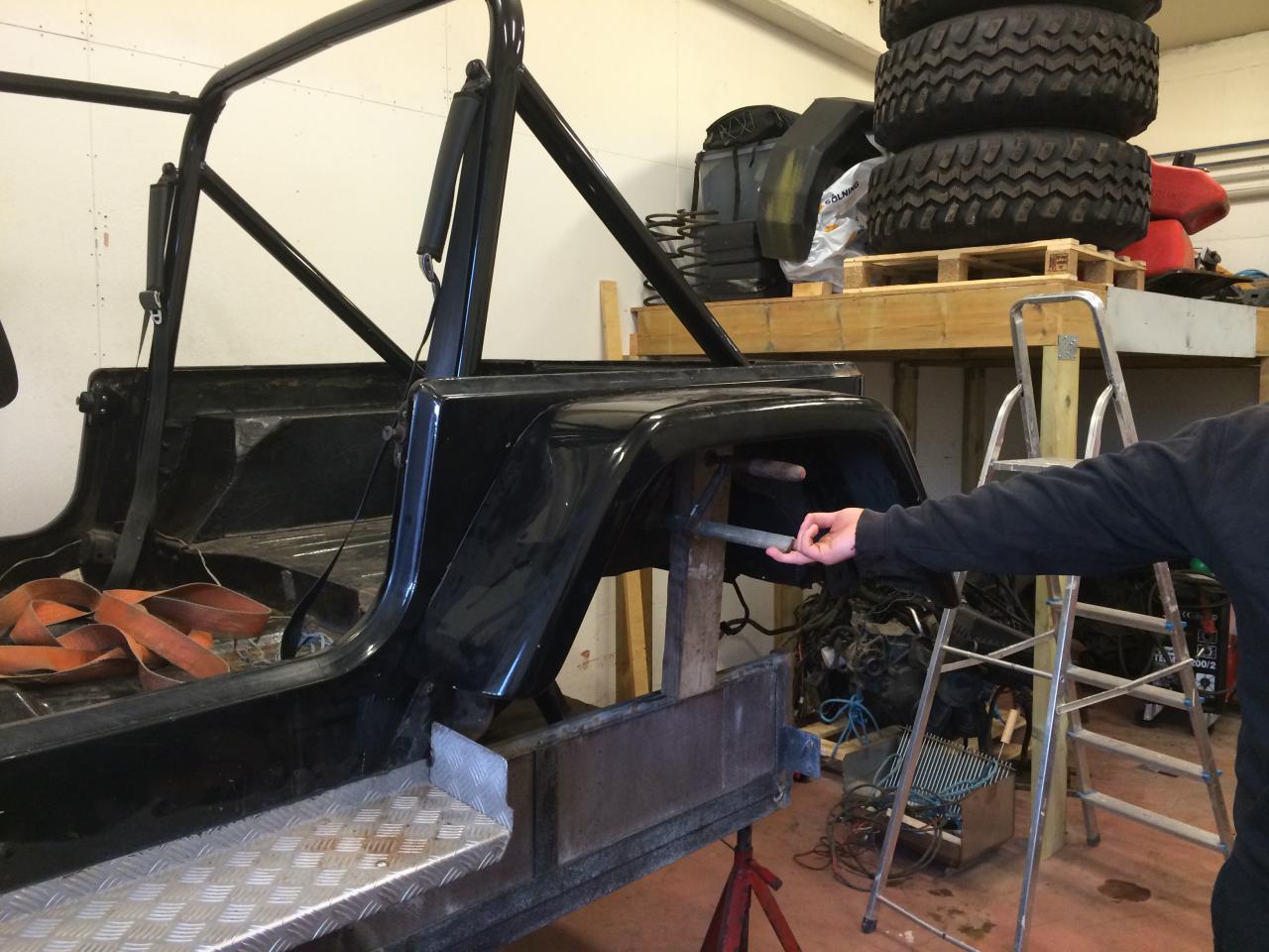

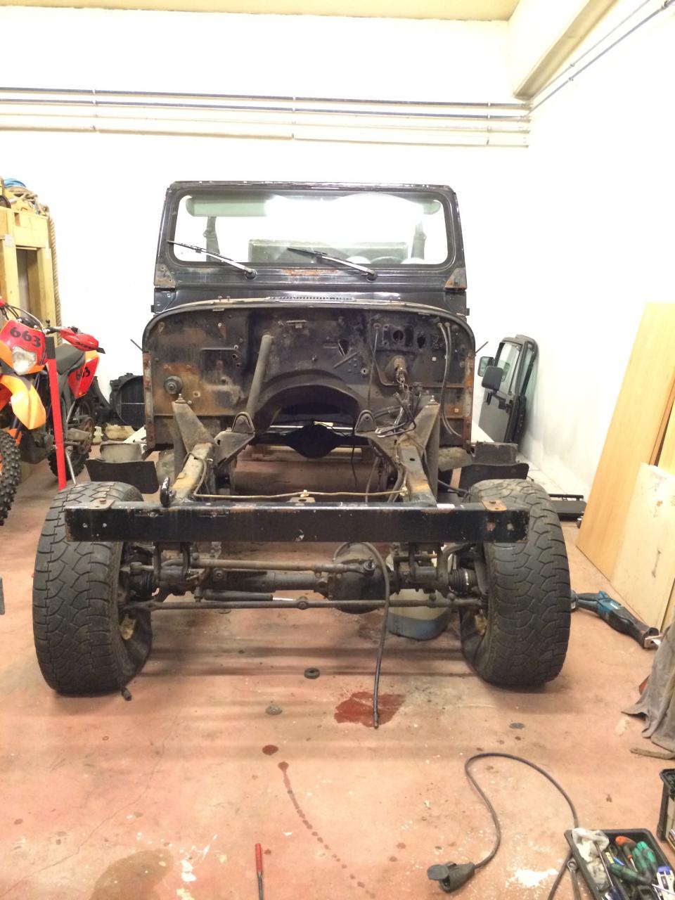

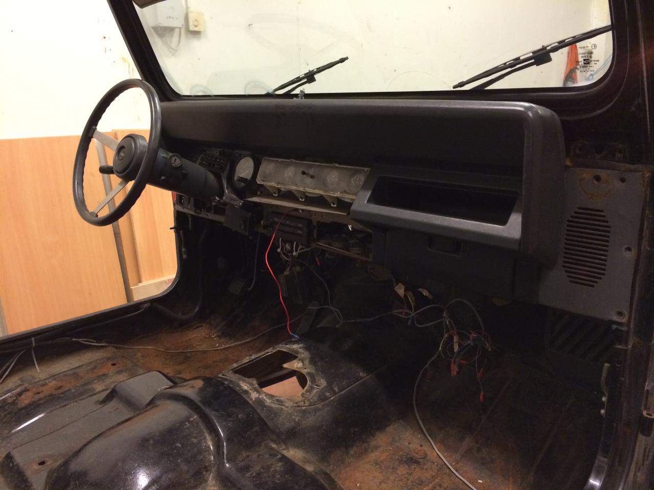

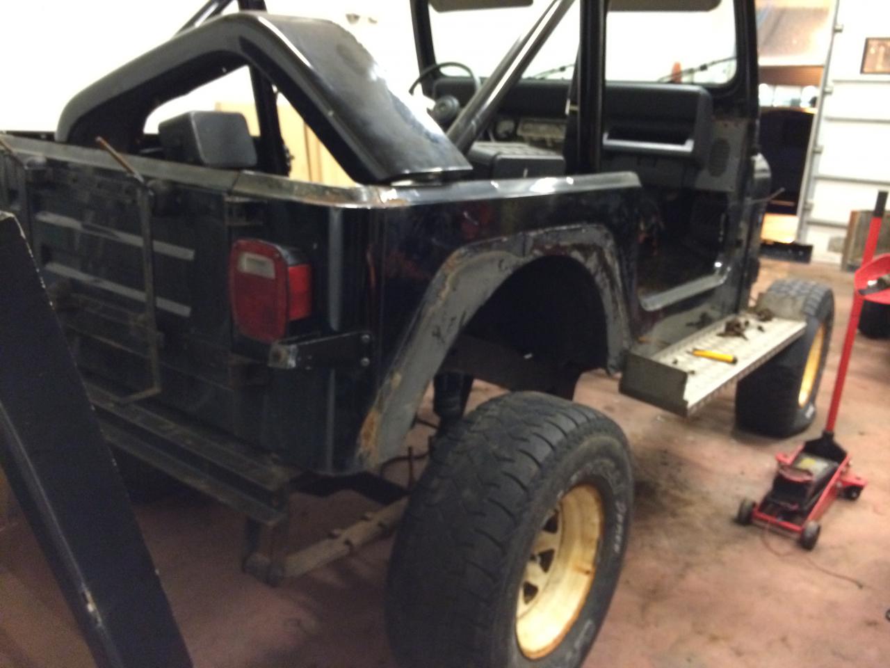

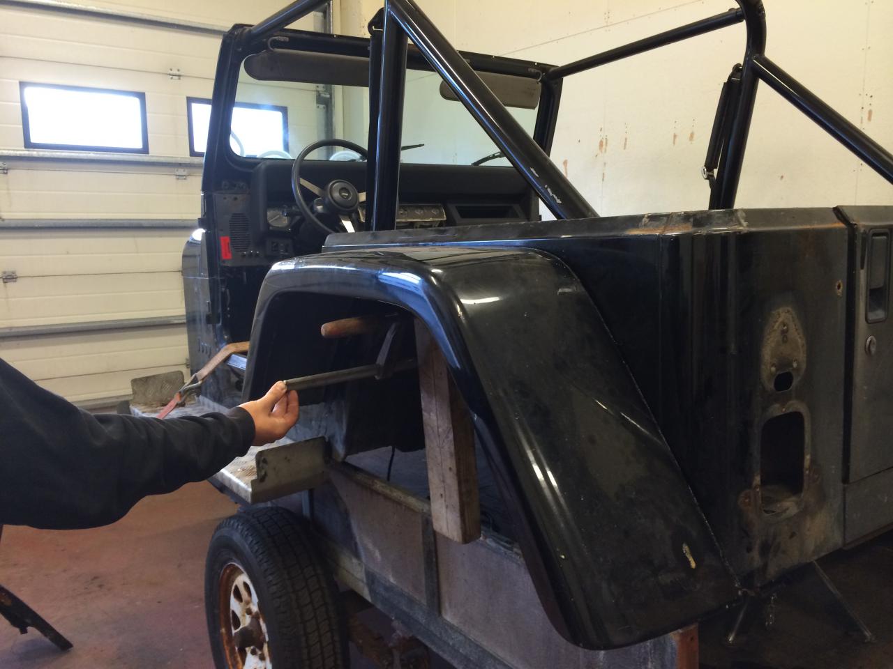

hér eru nokkrar myndir af þessu en vantar fleiri sem ég er búinn að taka
2014-09-10 21.26.09.jpg (143.31 KiB) Viewed 4514 times
2014-09-10 19.37.48.jpg (111.26 KiB) Viewed 4514 times
2014-09-10 19.37.38-2.jpg (144.46 KiB) Viewed 4514 times
2014-09-08 21.12.57.jpg (99.09 KiB) Viewed 4514 times
2014-09-08 21.12.46.jpg (102.62 KiB) Viewed 4514 times
2014-09-08 21.12.39-2.jpg (136.85 KiB) Viewed 4514 times
2014-09-08 21.12.28-2.jpg (134.23 KiB) Viewed 4514 times
2014-08-27 17.04.07.jpg (182.72 KiB) Viewed 4514 times
