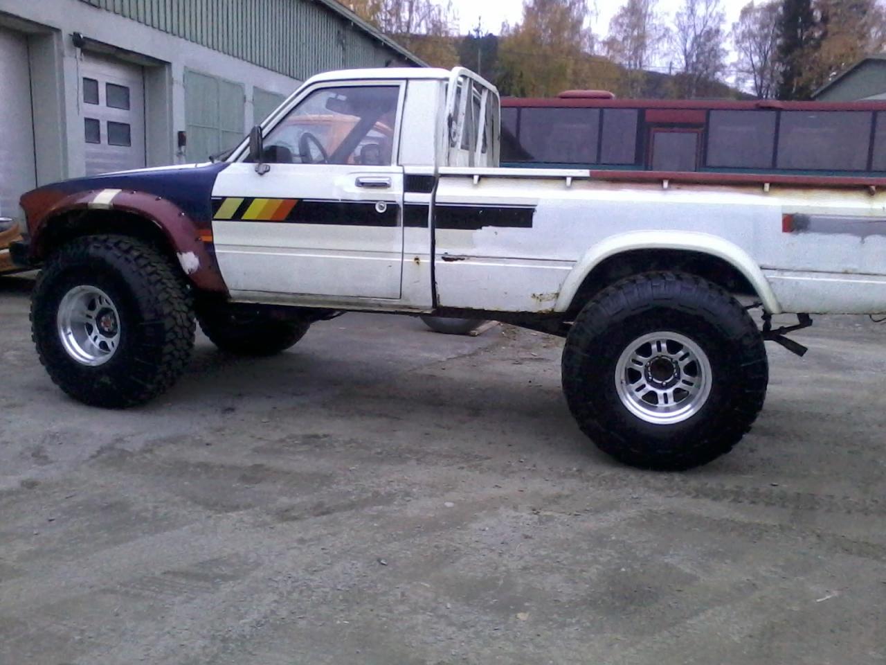

35" 0"lift
AT405 test
Need more lift. ca 2"

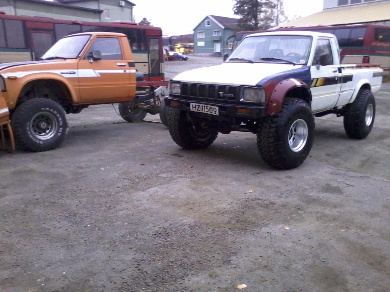

Posted: 24.okt 2012, 19:26
frá Pero
Not so many interesting pictures but it's something
Assisting a hilux with a flat battery
Beadlock rims

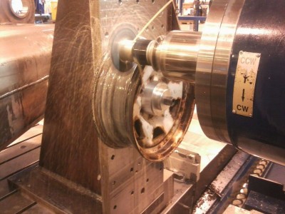

Posted: 24.okt 2012, 19:32
frá Pero

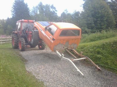

washer inside the frame

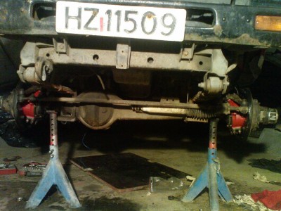

Have had to repair more than I building. Ruined a diferensial up front before christmas.
Mounted an LC 70 rear LSD diff front and new TG cromemolybden CV joint.
Everything inside is new now

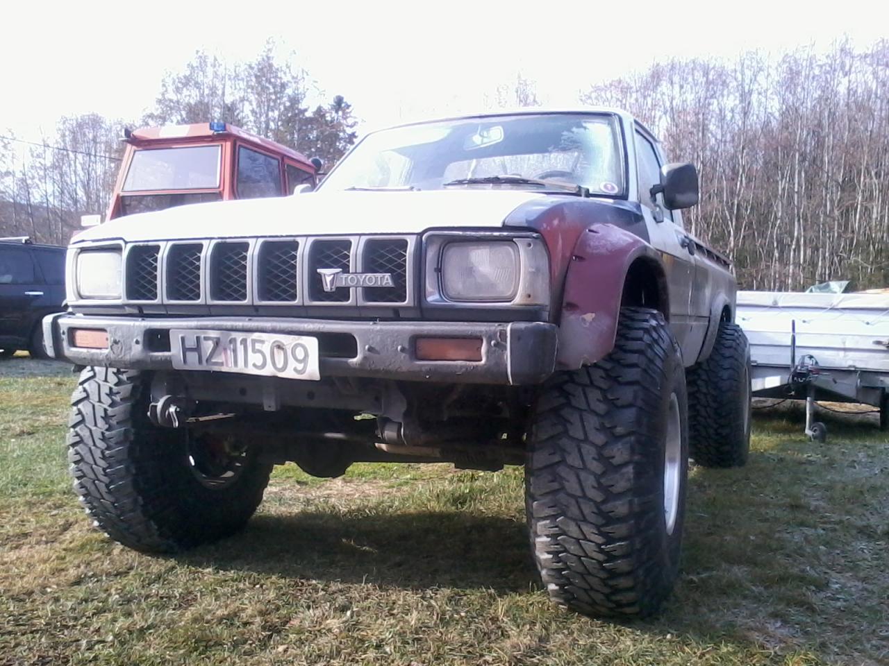

Posted: 24.okt 2013, 10:00
frá Pero
New wheels :D I hope the snow comes.. !
37x12.5-15 12.5x15 rims
2013-10-21 17.33.07.jpg (145.95 KiB) Viewed 6251 time
2013-10-19 11.24.39.jpg (180.32 KiB) Viewed 6251 time
2013-10-21 17.33.22.jpg (133.89 KiB) Viewed 6251 time
And new springs
