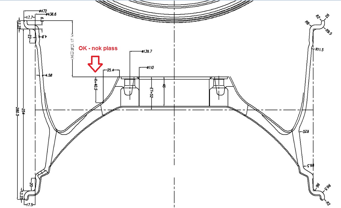

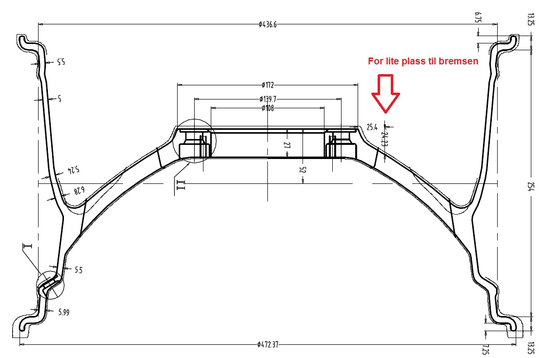

In practice this is what you want to end with, where alignment, length etc has to be adjusted in every case.
Image from this site
To modify a new Hilux to 44" tires as a full time job I would assume more than a week is needed when you have to take into account design work and some trial and error.

I'm pretty sure Arctic Trucks cut the body-mounts off the frame and move them up to lift the body and use the original body-mount bushings.
You need to cut the fenders wherever they're in the way. Cycle the suspension to see how much room the tires need, remember to turn the front wheels while checking for room. Keep in mind that you can limit the suspension travel with the bump stops and suspension straps.
I think you need to forget Arctic Trucks, try and get in contact with one of the other fabricators for tips, and possibly paid consulting and design.

Sunde
Innlegg: 46
Skráður: 22.des 2013, 11:49
Fullt nafn: Martin Sunde
Bíltegund: Hilux 3,0 38"
Re: Need help making a 2014 Hilux 39 to 42 inch
Postfrá Sunde » 08.jan 2015, 19:37
16 "rim depends on the type of brakes you have and the type of rim you want and use .
Hilux is supplied with 15 "and 17" brakes on model and country.
  42 to 14.5 R 17 "Goodyear kewl mt r is a good tire.
Adds two photos, one showing a rim, which does not fit and show a rim that fits 15 "brakes
right
wrong
