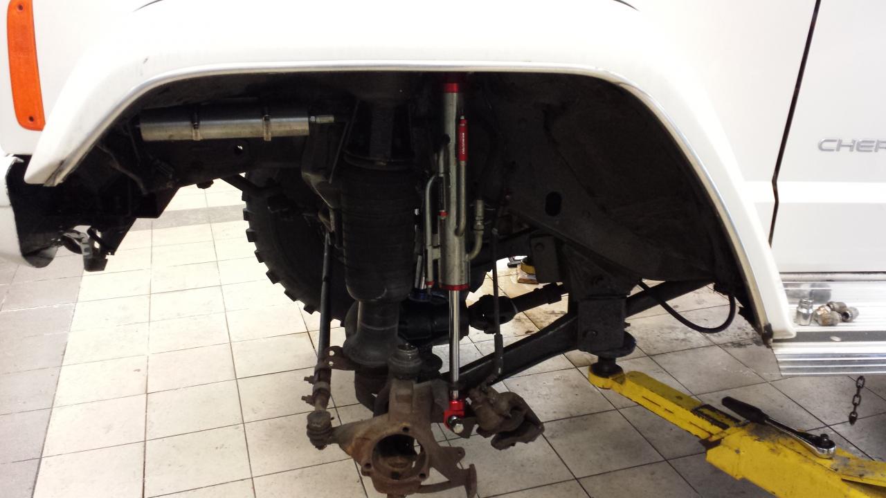

Bypass
2.5" 10" travel... svínvirkar hehe
