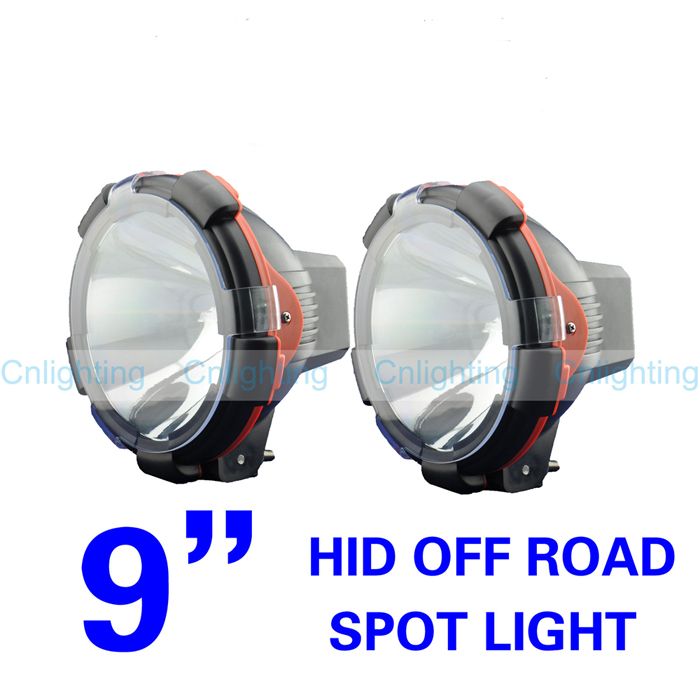

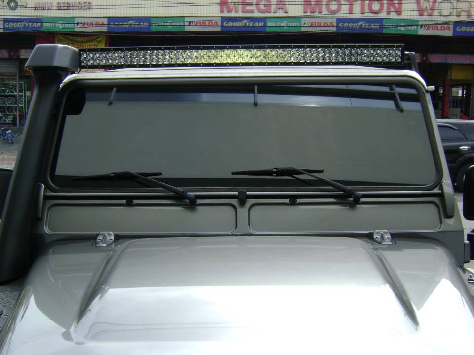

Er að skoða ljós á bílinn hjá mér.
Það kemur til greina að panta 42" Led bar eða 9" HID Xenon ljós. Info um ljósin eru hér fyrir neðan. Menn meiga alveg segja sína skoðum hvort er betra.
■LED Power: 240W
■ Operating Voltage: 10-30 DC
■Waterproof rate: IP 67
■80pcs*3w high intensity LEDS
■ Body Color: Black,White
■Color Temperature: 6000K
■Material:Diecast aluminum housing
■Lens material:Toughed glass
■Mounting Bracket: Alu firm bracket
■30000 hours above life time .
■Dimensions:41.5 inch
■LUM:Appro 75-90LUM/w
■Beam angle: Flood spot beam combo (*8F/64S/8F)
■Theoretical Lumens Output: 24000 LM
■Operating Lumens Output: 21600 LM
■ Amp Draw(DC): 20A /12V , 10A / 24V
■ The suitable design for heating elimination.
■ The high performance of tight waterproof,dustproof,quakeproof.
■Weight: 5.7kg (Per Unit Included The Box)
■Size:1119.2x78.4x86.5mm
■2 Years Warranty
■Package included:
1PC 42inch 240W LED Light Bar
2PCS Mounting Brackets
9" 75W HID Xenon
■Model: 909A-EURO
■Rated output power: 75w +/-3w
■Rated operating voltage: 9v-12v DC
■Output voltage: 105v +/- 17v
■Lens: PMMA Poly(methyl methacrylate),
■Material:Plastic
■Housing: High lmpact ABS
■Reflector: Die-Cast Aluminium
■Ballast: Slim type built-in
■Bulb: H3/6000K Xenon Bulb
■HID Bulb Life Time: over 2500 hours
■SIZE: 9 inch
■ Theoretical Lumens Output: 6000 LM
■ Operating Lumens Output: 5400 LM
■ Current draw: 6.25A/ 12V.
■ Light Pattern: 60° (Euro Beam)
■ Operation temperature -40°C ~ 105°C
■ Unit Dimensions: 275 x 255 x 180 mm
■ Unit weight: 1.80kg Approx.(with box)
■Package included:
2PCS 9" HID DRIVING LIGHTS
2PCS Protector Lens Covers
1PC Wiring Harness

Led Bar klárlega, gríðarlegur munur á ljósmagni , lítil orkunotkun og maður hreinsar bara af ef það skyldi koma snjór á þetta
myndi samt ekki mounta þetta eins og er á myndinni þarna fyrir ofan , þetta verður að vera framaná , annars er maður bara að lýsa upp snjókomu/rigningu
